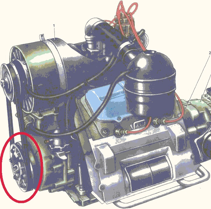

Pawel Can you say how you started the valve gap regulating procedure? Please answer to my questions:
1. Did you use BMT marking on the spinner (it is in the red circle on the picture below, click to enlarge)?
2. If yes, did you take off the high voltage distributor cover to understand which cylinder is in the top dead center (english meaning of the BMT)?
If no -- than the odds that you regulated the valves wrongly are 50:50.
I didn't know too many about BMT marking.
I read about regualting gap: when the valve is in highest position, and tappet (nosidła?) are clearance - it is ok.
No.
